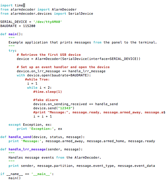

I am not a python programmer (yet). But I have cobbled together some code to send commands from a program to the keypad, and it works. But, I want to be able to see the messages back from the command on the terminal. However, I don't see anything from this code (see attachment). What am I missing to be able to see the resulting messages?

To see the messages FROM the panel you would want to override the on_message event, as such:
        # Set up an event handler and open the device
        device.on_message += handle_message
And you definitely don't want to keep assigning your event handlers in your loop as you are with the on_sending_received message - that will result in some weirdness.
Then define your message handler function as such:
def handle_message(sender, message):
    Handles message events from the AlarmDecoder.
    print sender, message.raw
It will print the "raw" message.
You can find the API Documentation here: http://alarmdecoder.readthedocs.org/en/ ... rmdecoder/

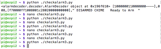

Well, I spoke a little too soon. The first time I ran the program it printed out the raw message. Then on subsequent executions of the script, nothing. See image below of the terminal window. Why would it behave this way?

You have to make sure to call decoder.close() on exit otherwise the serial port will not get released - will have to update the examples to show this.
