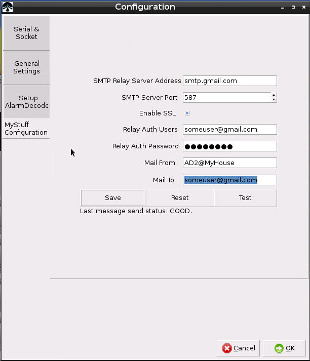

  1. Configure your AlarmDecoder for your panel.
  2. Install and run the AlarmDecoder Keypad software and connect to the AlarmDecoder directly or via ser2sock
  3. Import your providers ssl keys if needed.
  4. Using the "System Menu" go into the "MyStuff" tab and configure your email settings and press test to verify the email is working
  5. Restart the Keypad software and arm/disarm to verify you are receiving messages
